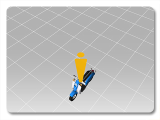

You may move the position of the whole scene, comparing with the dummy, to the location you desire. The moving directions along the axis map to the coordinate system in iClone.
Left / Right - Click the up arrow to increase the value of the scene position and click the down arrow to decrease it along the Red Axis. You may also key in the value into the edit box to move the scene.

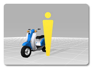

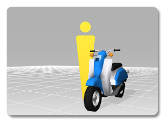

Move Left |
Move Right |
Up / Down - Click the up arrow to increase the value of the scene position and click the down arrow to decrease it along the Blue Axis. You may also key in the value into the edit box to move the scene.
Move Up |
Move Down |
Forward / Backward - Click the up arrow to increase the value of the scene position and click the down arrow to decrease it along the Green Axis. You may also key in the value into the edit box to move the scene.
Move Farther |
Move Closer |
