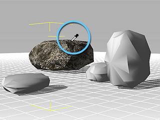

Select one mesh from where you want to share the textures and material settings.
Press the Pick button and click on the face of the material for sharing. The texture images and the material settings are thus retrieved.

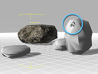

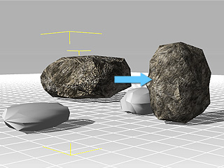

Press the Paint button and start to click on the target faces.

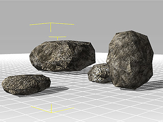

Repeat step 3 until all the target faces are assigned with the same textures and material settings (press ESC to cancel the Paint mode).
