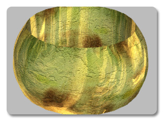

Model with texture from Sketchup Pro

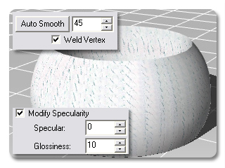

Model smoothed, original specularity

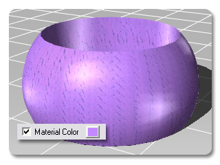

Material Color - If the node selected contains no texture maps, select and apply a new color and if the node contains texture maps, you can also enhance the texture with a color as a tint. Modify Color is unchecked by default.
Select a node in the tree view.
Check up the Material Color box.
Click the color box to invoke the color palette. Pick one desired color and click OK button.
Material
Color modified
Modify Specularity - Choose from two parameters, Specular and Glossiness. These parameters determine the material of the node, to make the node look gold, plastic, metal or wood.
Specular - The highlights created by light rays reflecting off a shiny surface. It is an important component of a material's definition because it suggests curvature in 3D space. Specular reflection depends on the position of the camera, whereas diffuse light does not.
Pick the node you desire to change the material attributes.
Check up the Modify Specularity box.
Press the up / down arrow button of the Specular to increase / decrease the strength of the reflection for the light rays.
Glossiness - It is the sheen or luster from a surface. The glossiness define the degree to which a surface approaches perfect optical smoothness in its capacity to reflect light. The higher the value is, the more the luster centralizes. It is presented by percentage hence the value ranges from 0 to 100.
Increase the value of the Specular.
Press the up / down arrow button of the Glossiness to increase / decrease the strength of the luster.
Specular and Glossiness modified
