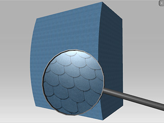

We can easily download SketchUp (SKP) 3D models and convert them into iClone. However, if the original model from Google SketchUp has no prior texture assignment (purely with default color material), then the result may be grainy when you apply texture in 3DXchange.
3DXchange provides a Texture Channel UV Offset and
a Tiling
feature to solve this problem. You may also use these features to best align a texture map to the target faces.

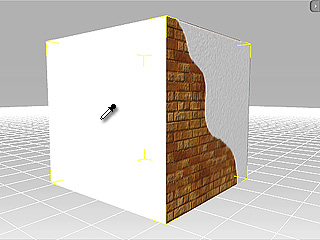

Select the mesh with grainy texture.
Press the Material Picker
and click on the face.

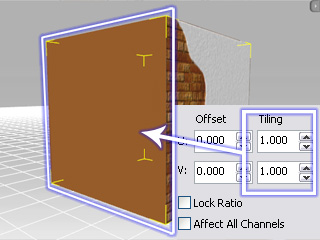

Select the Diffuse channel and click the
buttons
to load an image as the diffuse texture. In the illustration below,

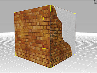

the massive grainy texture tile makes it look like
a solid color.
Adjust the Tiling value to
create an appropriate mapping result. In most SketchUp cases,
this is
a small value:
Tiling U = 0.010
Tiling V = 0.010

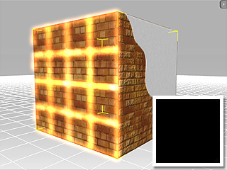

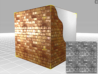

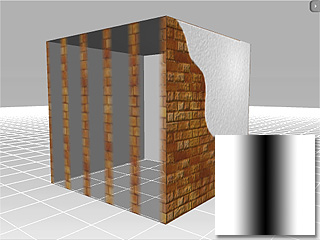

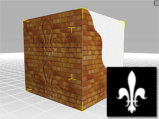

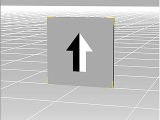

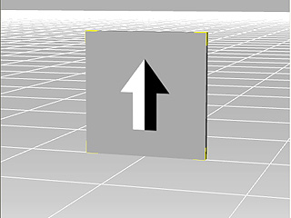

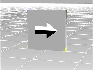

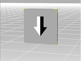

We can create many possible multi-texturing effects by altering the values of Offset and Tiling to different texture channels.
Opacity |
Bump |
Tiling U: 0.050 |
Tiling U: 0.010 |
Specular |
Glow |
Tiling U: 0.010 |
Tiling U: 0.040 |
Original Texture |
