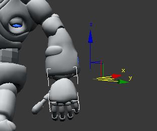

Click the bones one by one from parent nodes to child nodes.
Check the coordination of each node and find the color line that goes along with the bone direction. (R = X, G = Y, B = Z)
In this case, the red line is the global direction of the bone structure.
