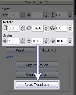

Reset Transform can also help you initialize one or more nodes of current size and orientation. The angle of the node will be set (0, 0, 0), and the size, (100, 100, 100).

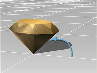

Use the Rotate Object tool to rotate the node.

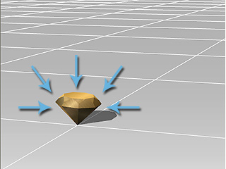

Use the Scale Object tool to scale the node.

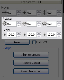

Click the Reset Transform button. The current transform status returns to be the initial status of the node.

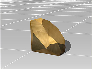

Before Reset Transform clicked |
After |

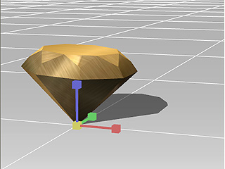

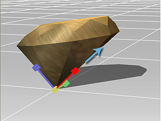

After you rotate a node, its Gizmo will be rotated as well. This increases the difficulty as you want to scale the node (uniform scaling excepted).

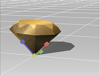

Gizmo rotated along with the node |
Scale direction |
Click the Reset Transform button in order to rectify the direction of its Gizmo and align the direction of the scene root coordination.
