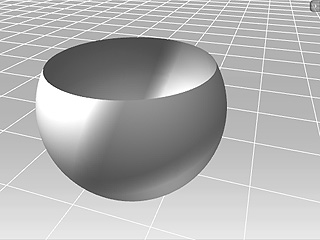

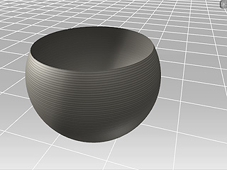

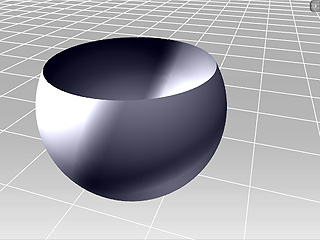

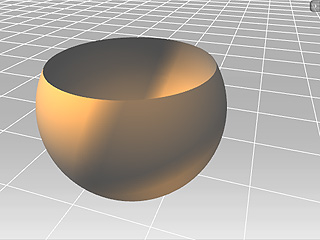

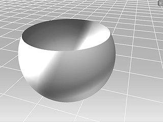

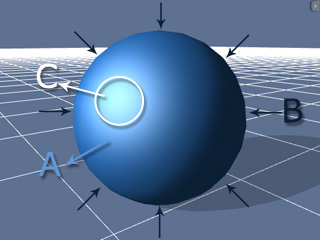

A. Diffuse Color: The Diffuse color defines the overall color that is reflected on an object. B. Ambient Color: The Ambient color refers to the illumination surrounding a subject or scene. C. Specular Color: The Specular color only defines the color of the highlighted area of an object. Therefore, you must decrease the Diffuse color to see the effect. |
Diffuse Color = |
Diffuse Color = |
Diffuse Color = |
Diffuse Color = |

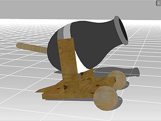

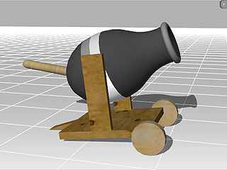

The Opacity setting decides the transparent level of a mesh, but no real-life distortion appears in the mesh bumps.
Opacity = 50 |
Opacity = 100 |

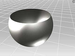

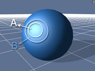

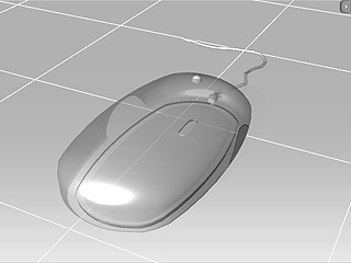

A. Specular: The Specular value defines the strength of the highlighted area of a mesh. B. Glossiness: The Glossiness value defines the range of the specular on that type of the material. |
Plastic: |
Metal: |
