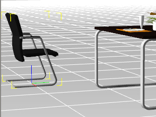

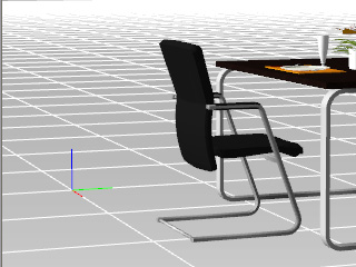

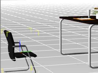

Load a model with meshes.
Select the nodes. Click the Make Sub-Prop button to generate one of their Sub-Prop nodes.

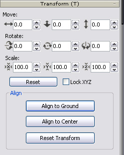

Click the Align to Center or the Align to Ground button in the Transform section.
The Sub-Prop, in accordance with the center or the bottom center of the bounding box, will be aligned to the origin.
Align to Center |
Align to Ground |
