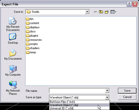

Select File>Export... to export the scene.
Choose Wavefront Object (*.obj) file type.

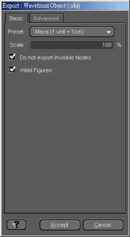

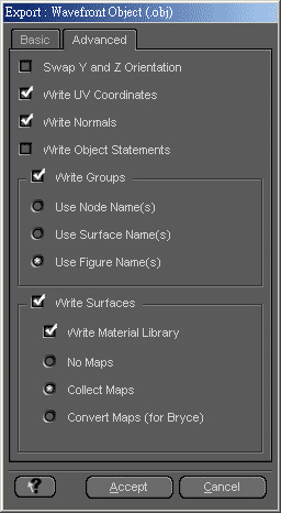

In the "Export" dialog box, set the options as follows:
*Notice: in the "Write Groups" option, choosing "Use Figure Name(s)" will make the figure model a single node. This is good for smoothing and removing any seams on the model surfaces, but take longer time to load and process in 3DXchange.
The other two, "Use Node Name(s)" and "Use Surface Name(s)", setting will export the figure into multiple nodes. The loading will be faster when the same face counts are shared by multiple nodes, but there will be visible seams between mesh nodes.
Click "Accept" to export the obj.
