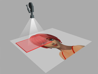

  1. Double-click on the desired camera key to invoke the Camera Editor panel. Please note that the key in our example already contains offset data.
    Camera with Transformation Key

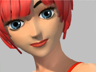

    Viewport Result
  2. Select move, zoom, and/or rotate, then drag in the interactive area to modify the camera position and angle as many times as you want.
    Camera Transformed

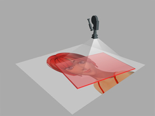

    Viewport Result
  3. Since it is hard to retrieve the original state manually, click the Resume button to abort all modifications.

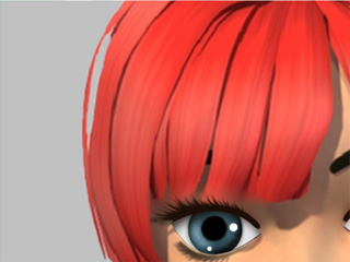

    Transform Key Resumed

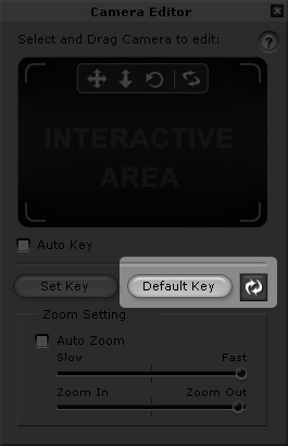

Setting Default Key
Each time you want to remove the transformation key (move, zoom, rotate) and go back to the initial status of the camera, perform the following steps:

  3. Click the Default Key button and the offset data will be cleared. The camera goes back to its neutral position and the original key will be replaced by the neutral one.

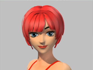

    Camera to Default State
    Viewport Result
