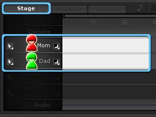

  1. Given are two models whose layer orders are described as follows:
    Model Page
    Layer Status in Stage Panel
    Two models are added.
    (The female model is added before
    the male model)
    The female model has the higher level
    than the male model.

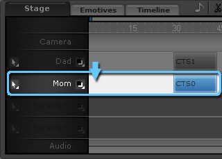

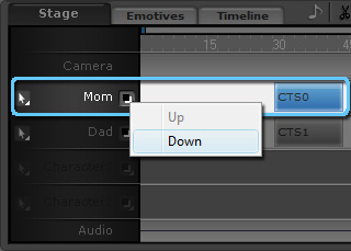

  3. Click the button besides the name of the female model and select Down in the pop-up menu to move the model down one level with all the talking scripts.
  4. The female model with effects will be covered by the male model as a result.
