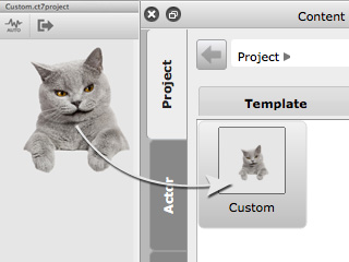

Switch to Project on the top panel.
Save your current project by clicking the Add button under the Content Manager.

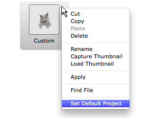

Right-click on the newly-added template icon. A menu will pop up.
Select Set Default Project.
Restart CrazyTalk. The new project has now
replaced the initial default project (white background).
