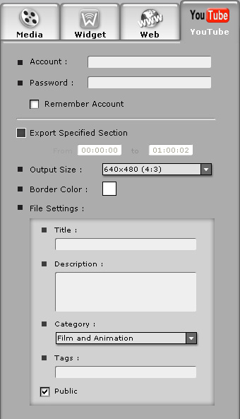

CrazyTalk provides this feature so you may directly upload your project to YouTube instead of having to export files, waiting for rendering, browsing to the YouTube page and uploading the exported video files manually.
Click the YouTube
tab to toggle the
output mode.
Enter your data into all fields on this page (these fields cannot be empty in order to upload files).
CrazyTalk uploads the video into your account with your account information.
If you wish to enter more than one tag in the Tags field, please separate them with a space. Your visitors will quickly be directed to view videos related to the tags from your YouTube video page.
Check the Export Specified Section option if you only want to export a specific part of the project.
Specify the Output Size from the drop-down list.
Click the Go to YouTube
button to open the YouTube webpage in your default
browser. Click the Upload
button to directly upload this
project.
