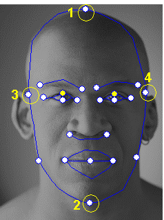

  • How can I fine-tune the model image for more realistic facial movement?
  1. The control point 1, 2, 3 and 4 are the key to control the facial mesh morphing. 1, 2 control the vertical movement strength and 3, 4 controls the horizontal movement strength.
  1. Press Motion Settings on model page and checked the Head Motion Preview can preview the movement. If not perfect, you can close the dialog and try to change the location of control point 1-4.

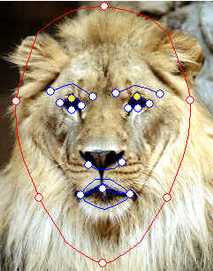

  1. The outline control points should keep to the outside of the facial area.
Select the complete facial outline by clicking the wire frame, not the control points, of the facial outline Then use the Scale button to resize the entire facial outline so that it lies completely outside the subject's face.
