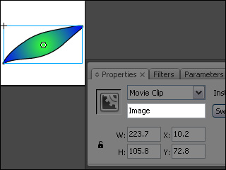

  2. In the working area, drag and drop the eyelid symbol to the center of the document.
  3. In the Properties panel, type Image to the Instance Name text field.

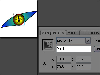

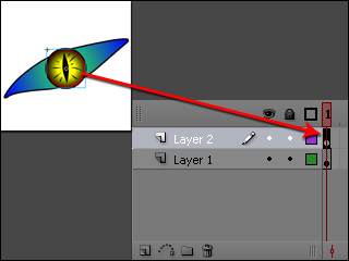

  4. Create a new layer, drag and drop the eyeball symbol to the center of the document in this new layer.
  5. In the Properties panel, type Pupil to the Instance Name text field.

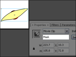

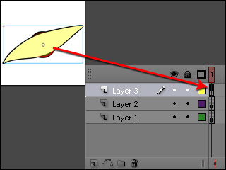

  6. Create a new layer, then drag and drop the mask symbol to the center of the document in this new layer.
  7. In the Properties panel, type Mask to the Instance Name text field.

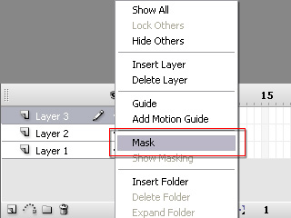

  8. Right click on the new layer and select Mask, it will now mask out the pupil instance.
