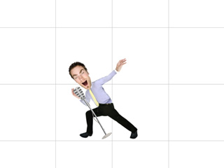

You may also change the Grid Spacing value to decide the size of the grid cell .
The grid spacing = 50 |
The grid spacing = 10 |

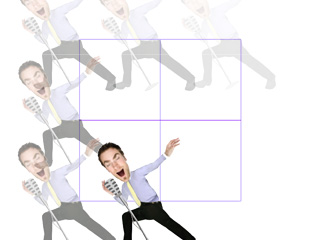

The Gird Size decides the number of the grid cells on both sides of the gird.
Grid size = 1 |
Grid size = 2 |

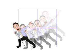

Check the Snap to Grid box so that your objects always snap to the intersecting points on the floor grid when they are manipulated by the Move tool.
Snap Grid = OFF |
Snap Grid = ON |

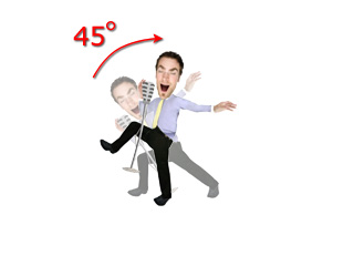

You may check the Angle Snap box and define an angle that your objects will snap to when they are manipulated by the Rotate tool. They will rotate by the specified angle each time.
Angle Snap= 45 |
