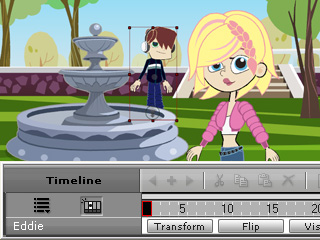

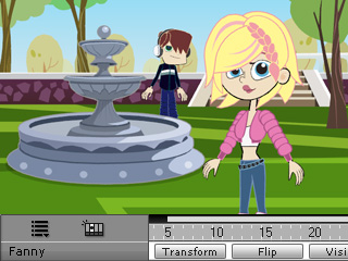

Press the Object-related Track button.
Pick a character in the working area. The timeline will then only show the name of the character and its track buttons.
Pick a prop in the working area and the timeline will hide the character's track, and only show the name of the prop and its track buttons.

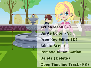

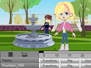

Make sure that the Object-related Track button is not pressed down.
Right-click on another item in the working area to display the right-click menu.
Select the Open Timeline Track in the menu.
This item will then be shown in parallel with the character.
