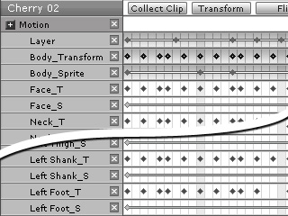

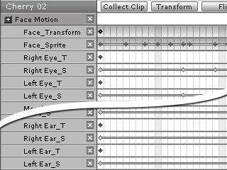

Grouping Keys
Select a character or a prop. Use the
Motion Key Editor (for characters),
the
Prop Key Editor (for props), and the
Sprite Editor (for characters and props) to add keys.
You will see a lot of keys shown on the sub-tracks, under the Voice Clip, Facial Clip,
Face Motion and Motion tracks in the timeline.
In the Master or Main Tracks, drag to form a range that captures all the transform keys, and sprite switch keys, under them.
Group the keys to form a new clip:
Group by clicking the
Group button on the timeline tool bar.
Right-click in the range and select the Group command from the menu.
