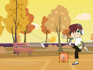

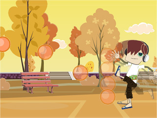

In CrazyTalk Animator, you can have characters, props and image layers show or hide during different time frames. However, since each object can only have one path form (curve or line), then you may use the Visible Setting option to have an object move with mixed path forms.

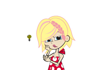

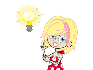

As soon as you add them, effects in CrazyTalk Animator loop from the first to the last frame of the project. So if you need the effect to start at a specific time frame, then you need to hide it until you want it to appear.
Show/Hide button. The eye button icon will then close
and the effect will be
hidden.

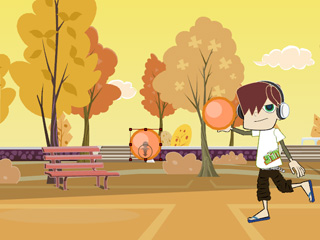

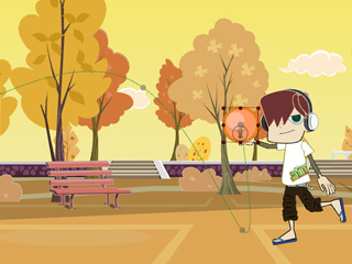

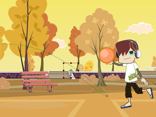

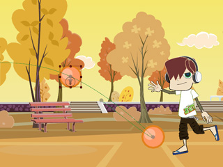

In CrazyTalk Animator, the moving path form of an object (character or prop) can only be a curve or a straight line. If you save the object into the content library, then you may move the object with mixed path forms by using the Show/Hide feature.
Show/Hide button. The button will change
and the second prop will now be hidden.
