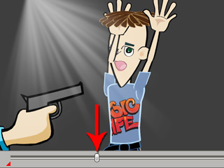

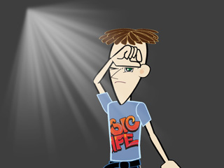

Set a pose to a character in a time frame.

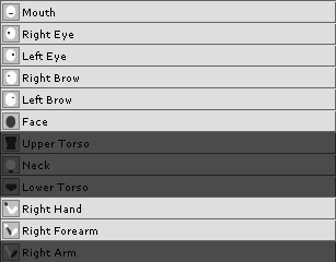

The hand and forearm in the layer order, as it is in the Composer Mode, are behind the head.
Re-arrange the layer order by setting layer keys. Please refer to
the Setting Layer Keys for Characters section for more information.

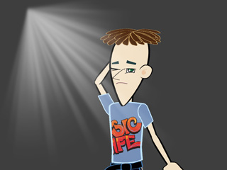

Go to the previous time frame.
Click the Release button to retrieve the initial layer order
as in the Composer Mode.

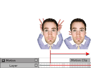

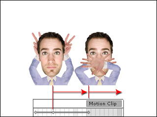

Apply a motion with re-arranged layer keys in it.
Set layer keys before the motion. You will then see that the layer order
in the motion clip is
overridden by the last layer key in the Layer track.

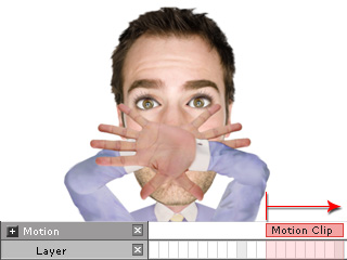

Set a Release key at the start frame of the motion by clicking the Release button on the
Layer Tab.
The layer order in the motion will be kept.
