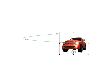

  1. Select a character or a prop that moves from right to left and right again along a path.

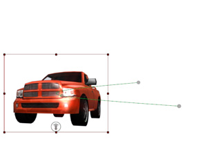

  2. Once the prop reaches the middle point of the path, it will be necessary to flip the prop's facing side.
  3. Drag the play head to the time frame where the character or the prop's side is supposed to turn.
  4. Click the Flip button on the tool bar above the working area. The prop will then be flipped for the rest of the path unless you flip it again.
    By default, characters and props flip horizontally. You may drag down the list and click the triangle to set flip to horizontal or vertical.
