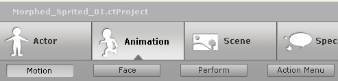

The easiest way to have a character move is to apply templates from the Content Manager. To do this, simply click the Animation tab
on the top panel.

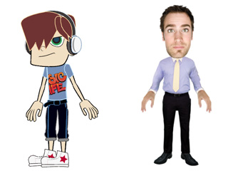

Front and Side Motion Templates
When you apply a motion template from the library, please make sure you check if the character body pose is in a front stance or a side stand, and remember to apply
a motion template accordingly. Take note that mixing and matching different types of templates (front and side) may sometimes cause layer conflicts.

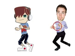

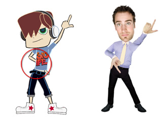

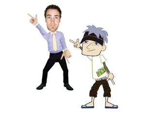

Side and front characters
Front Motion Applied
Side Motion Applied
