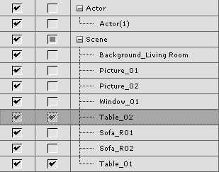

In the Scene Manager, expand the Scene items.
Activate the Lock box beside the props you do not wish to pick.
Activate the Lock box beside the Scene item in order to lock all the props under that Scene entry.

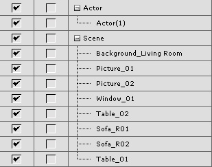

Now the locked prop cannot be selected in the working area, unless the
lock box is inactivated.

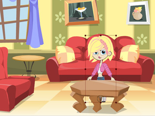

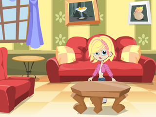

Click on the locked table to only select the character.
