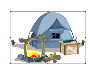

In the Stage Mode, select a compound prop created earlier.
Click the
Prop Composer button.

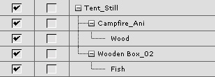

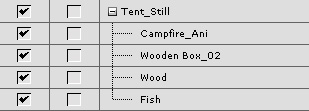

Switch from the Scene Manager to the Scene tab.
The sprites are all under the root node.

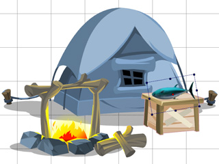

Select a sprite which is a child of another one.
Click the
Attach button
and pick another sprite which you want as a parent.

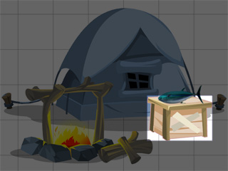

The sprite will then be moved under the new parent.

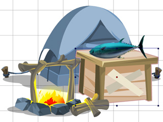

If you transform the parent, then the child will be affected as well.

If you need to detach the sprite, then use the Attach feature and then pick the root sprite to detach from the new parent.
