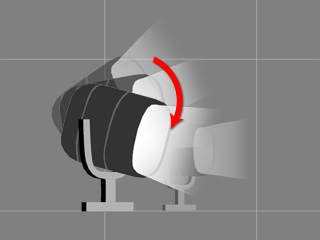

Merging Props with Transform Animations
Apply or create different props.
Click the
Transform button
on the toolbar to open the Object Transform panel.

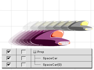

Adjust their transform data to create animations for all, or some
of the props.
Select all the desired props to produce a composite prop.
To select the desired props, you may:
Ctrl + Click on the desired prop in the working area, or in the Scene Manager.
Drag a box to surround the desired props.
Click the
Merge/Unmerge button on the tool bar to merge the props.
Alternatively, you may Right-Click in the working area and select the Merge command of the Right-Click menu.

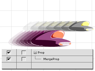

Play back. Although they are turned into a merged prop, the animations of each
component are kept.

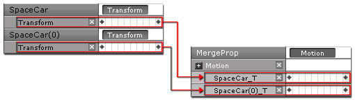

Please note that only the Object Transform keys and the Sprite Transform keys will be kept after
the merge or unmerge procedures.
The Object Transform keys will be transferred to the (Prop Name)_T track of the merged prop after the merge procedure.

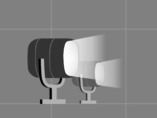

Merging Props with Sprite Transforms
In the last section, the props have individual transform animations.
However, even props with sprite transform animations can be merged.
Apply or create different props, and make sure that some of the props
contains multiple sprites.
Select one of the props.
Click the
Prop Key Editor button on the toolbar to open the Prop Key Editor panel.
Transform the sprite in a different time frame to create a sprite animation.
Click the
Play back and the sprite animation will be kept.

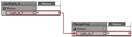

The Sprite Transform keys will be transferred to the (Sprite Name)_T track of the merged prop after the merge procedure.
