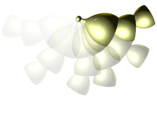

Making a Sprite-Chain Prop
If you want to create a prop with chained sprites, then you can use the Attach feature found in the Prop Composer mode.

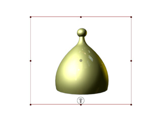

  1. In Stage Mode, select a prop and save it into the prop library.

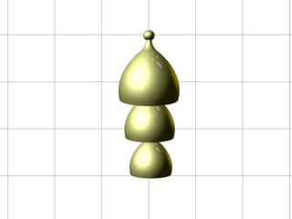

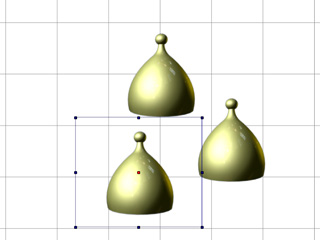

  3. Search for the sprite in the library you saved in Step one. Drag and drop it into the working area twice.

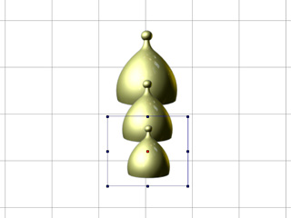

  4. Move, rotate or scale the sprite to the appropriate position.

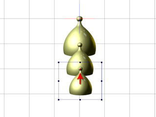

  5. Set the pivots for each sprite to the right place for correct rotation.

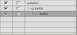

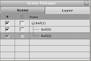

    The hierarchy in the Scene Manager:
  6. Use the attach tool to set the sprites into a tree structure.
  7. Change the layer order if necessary.
