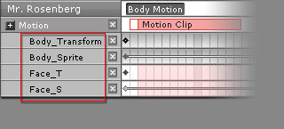

The Motion Layer tracks are important tracks for fine-tuning an actor's motion. You may
generate simple Key Frame Animation or add
Animation Layers to an existing
animation clip. Basically, all the sub-tracks under the main Motion track, are motion layer tracks.
Given a motion on a character- before the motion is modified with a Transform key.
The motion will be modified after being affected by a Transform key.
Given an existing motion of a character - before the motion is modified with a Sprite switch.
The motion will be modified after being affected by a Sprite switch.
