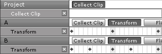

Press F3 to open the timeline. Click the
Track List button and select Project from the menu.
Click the Collect Clip button to show the track.

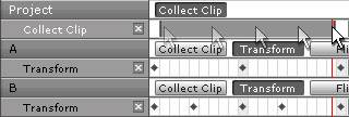

Drag in the track to make a range for deletion.
Click the
Delete Option button.
You will then be prompted to choose the deleting method.
Delete Data: Delete only the clips, keys and switches within this range.
Delete Frame: Delete keys, switches, as well as the frames within this range to shorten the length of the project.
If you Delete Data, the data within the range will be removed. The previous data after the range
will stay where it is.
If you Delete Frame, the data and frames within the range will be removed. The previous data after the range will be advanced.

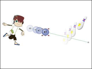

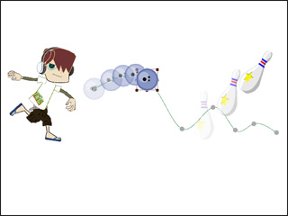

Given a project with two props animated by keys. The pin moves away
before the ball hits it.

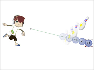

If you Delete Data, the data within the range will be removed. The previous data after the range will
stay where it is.
