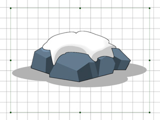

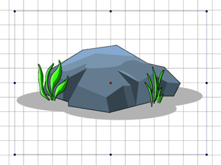

  1. Creating a Prop from Multiple Media

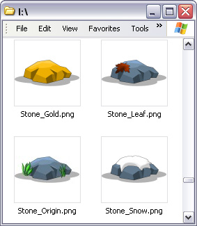

    1. Select multiple media files from the source folder in Stage Mode.
    2. Drag and drop into the working area of CrazyTalk Animator.
    3. A new prop will be generated with a sprite containing media files.

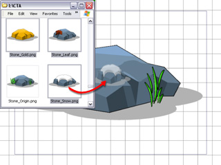

  2. Appending Media to a Sprite
    1. Select a prop. Switch to the Composer mode.
    2. Select a single, or multiple image files, from the source folder.
    3. Drag and drop them onto the target sprite inside the working area of CrazyTalk Animator.
    4. Pick the sprite and click the Sprite Editor button. Now all the media will be converted into elements of the sprite.
