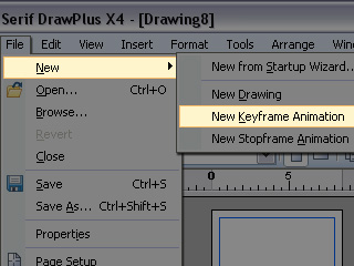

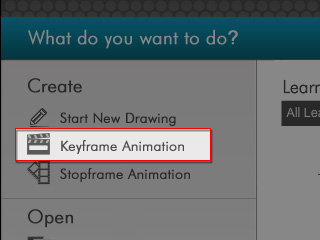

When you begin a new project, please remember to select the Keyframe Animation setting, because the Keyframe Animation projects are able to export most media files that are supported by CrazyTalk Animator:
Click the |
Use the main menu to new project. |

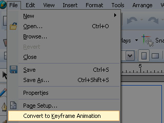

If your project is not produced using the Keyframe Animation setting, please go to File >> Convert to Keyframe Animation in the main menu.

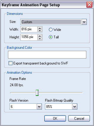

You may need to set the frame rate of your project in DrawPlus to the same number as in CrazyTalk Animator in order to produce a consistent playback result in both applications.
The Flash Bitmap Quality determines the size of the exported SWF files, especially when there are image objects in a project. The higher the value is, the larger the size of the SWF file; and vice versa.
The recommended value is 85 (or above).

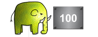

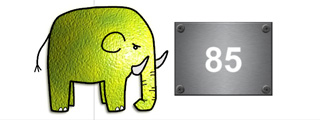

DrawPlus project with image object |
Results with different quality (No obvious differences) |
File Size |
33.5 KB |
67.0 KB |
