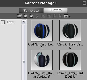

However, when you save a material file, the default thumbnail will shape like a ball. To make it clearer to the users, you need to change the thumbnails.

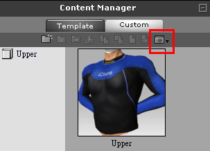

1-2. Go to Avatar/Upper and create a custom upper body by pressing the Add button
1-3. Maximize the custom upper body icon by pressing the View button
1-4. Use your screen capture software to capture the icon and save the file as jpg

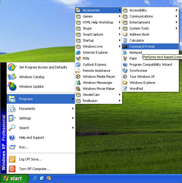

2-1. Open Command Prompt.

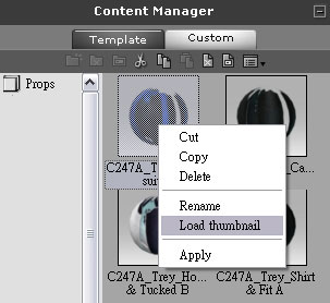

3. Load thumbnails to these prop files.
3-1. Now go to Set/props. You will find your material files there.   3-2. Right click on the file which you want to change the thumbnail, and choose Load thumbnail.

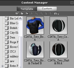

3-3. Voila! You now have made a thumbnail for the material
3-4. Repeat the above process to make thumbnails for lower bodies and shoes
4. Convert the prop files back to material files.
4-1. Rename the vns files back to Material files by going back to Command Prompt and type in ren *.vns *.iMtl.
You are now ready to submit your very first G3 texture pack!
