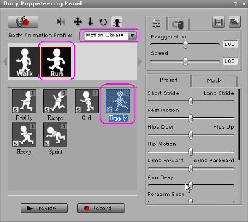

Click on the Puppet Editor Button to open the Puppeteering Panel.
3 |
Select a motion that you want to puppeteer in Motion Library 1/Run (eg. Happily), and click the Preview button. |
Press Space and you will see the animation playing continually. |

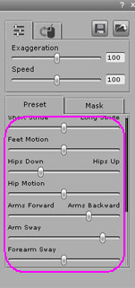

You can adjust the slider at the same time while playing. |
When you are satisfied with the adjustment, press Space again to stop previewing. |
